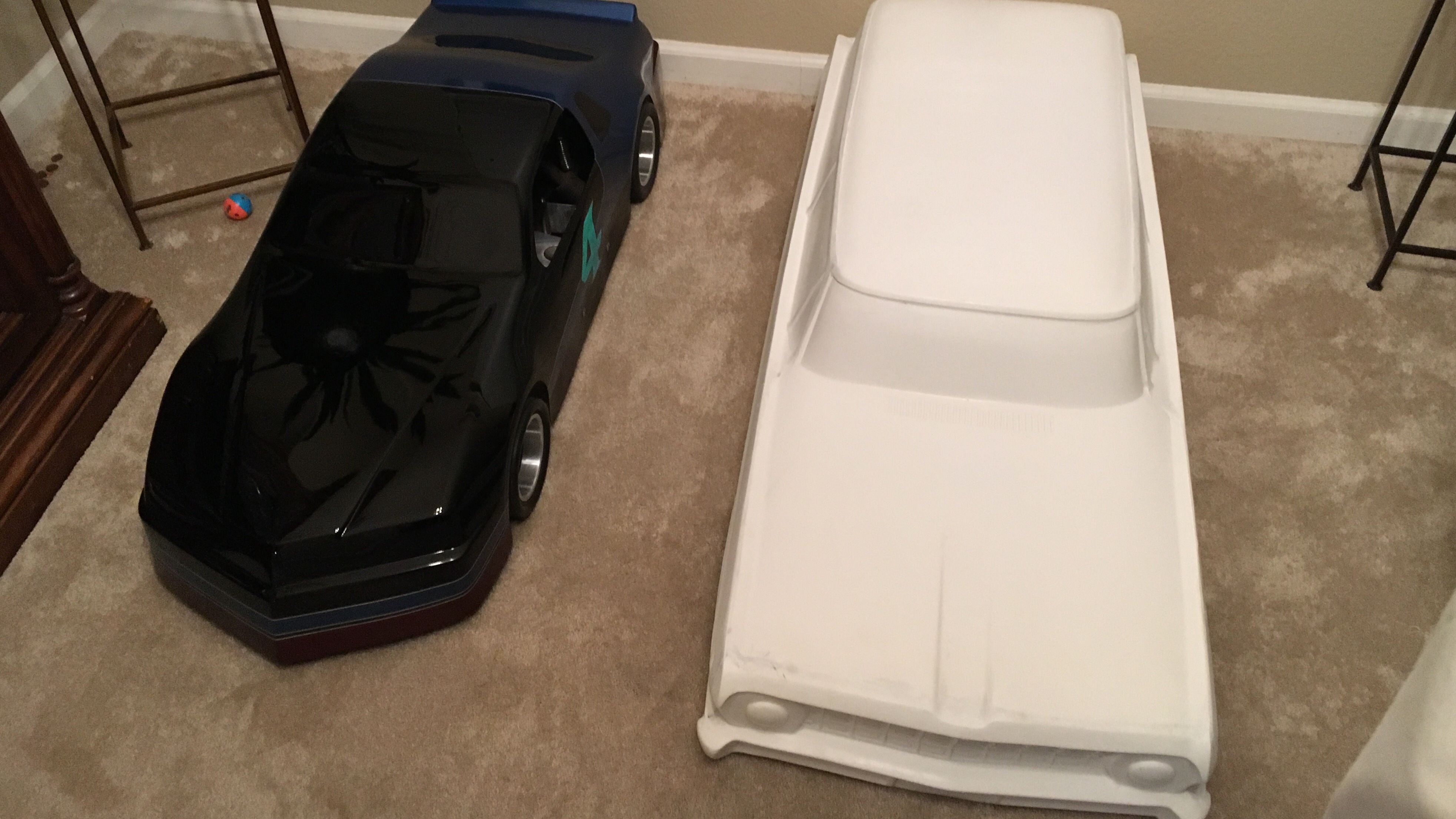

One of those bodies you see on Ebay
Going to build a 60s style gasser using a modular style frame (like a raco) but with a skellenger style rear axle and a Delara front axle..., good way to make use of a parts lot.
This body sitting next to my Raco.. it can fit completely under the ebay body

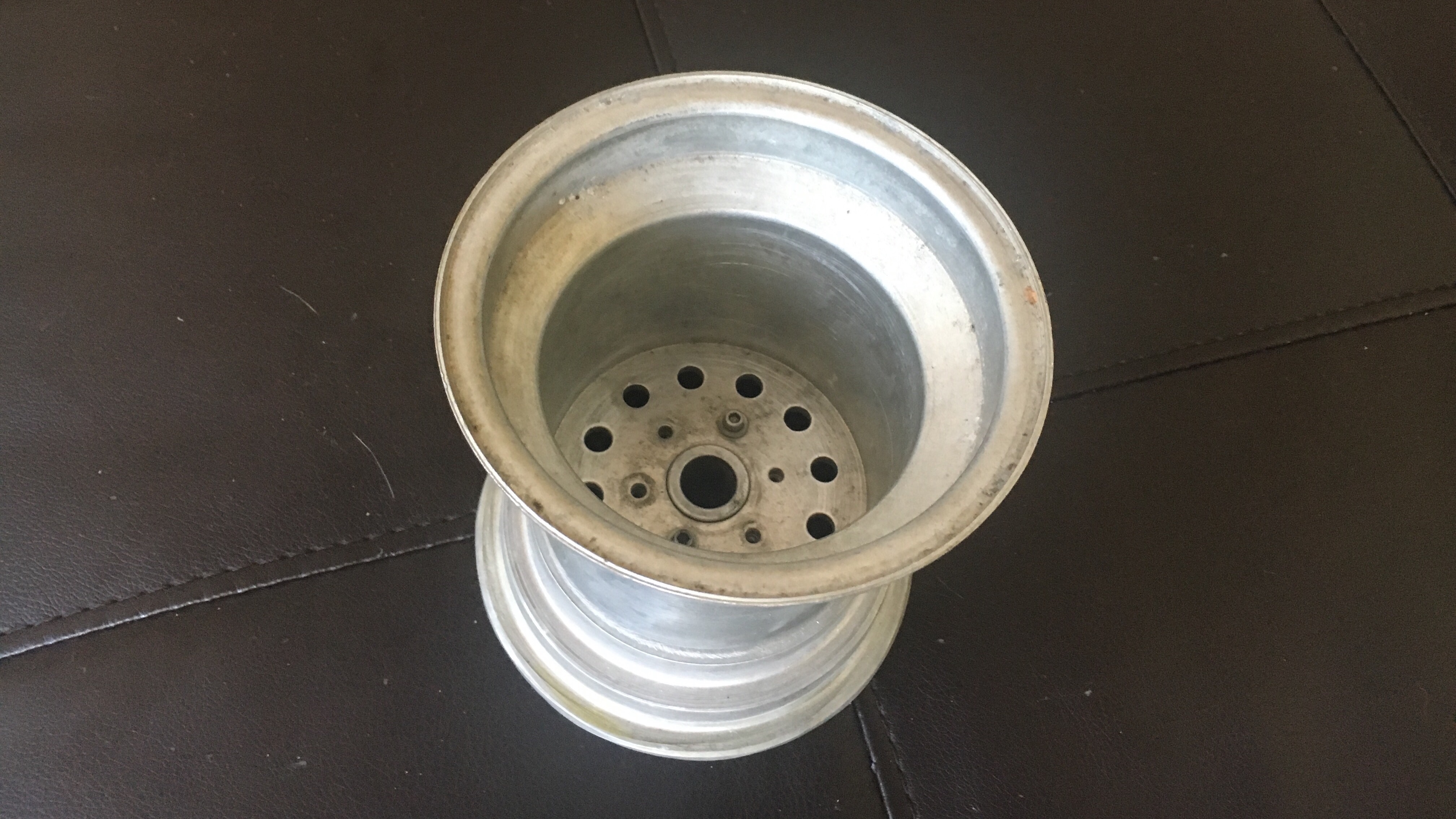

I want a lot of tire sidewall like the gassers had back in the day and I think kart wheels will be out of scale...
I have a pair of these that are not perfect but might clean up 85%.. nice thing is they are a massive 5.5 inches wide

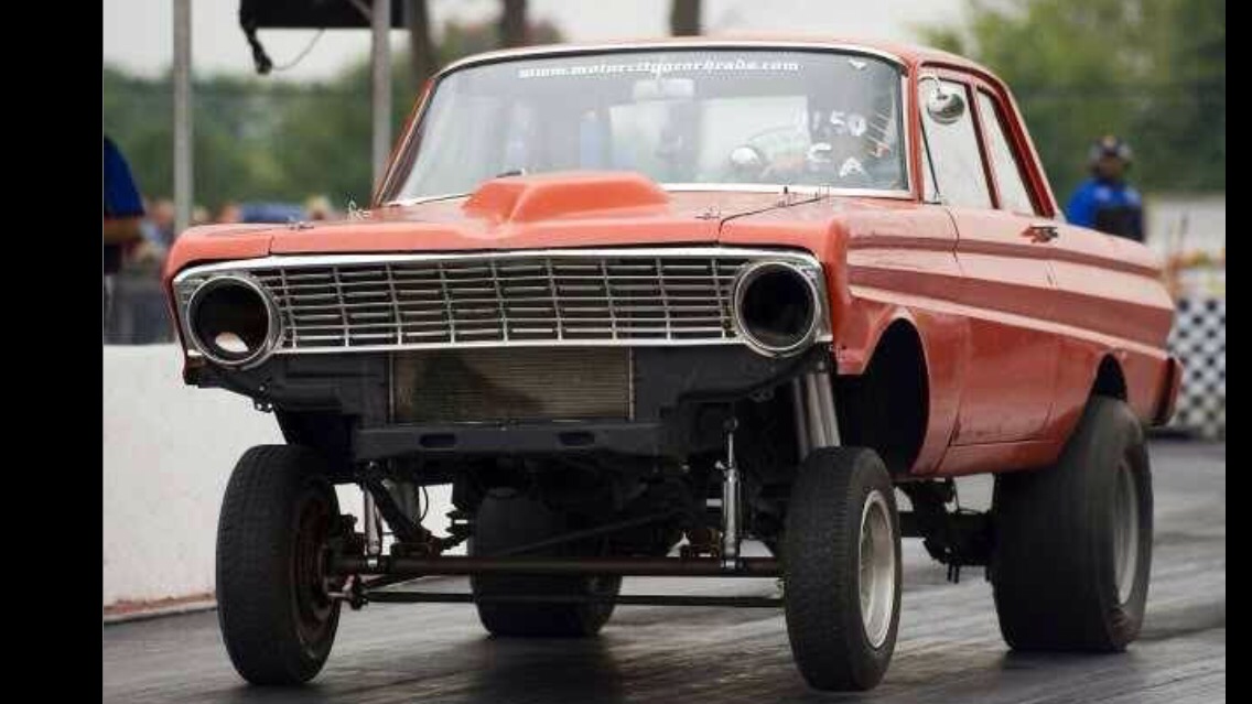

I plan on reworking the body to be a 2 door sedan .. this real 64 falcon gasser is my motivation

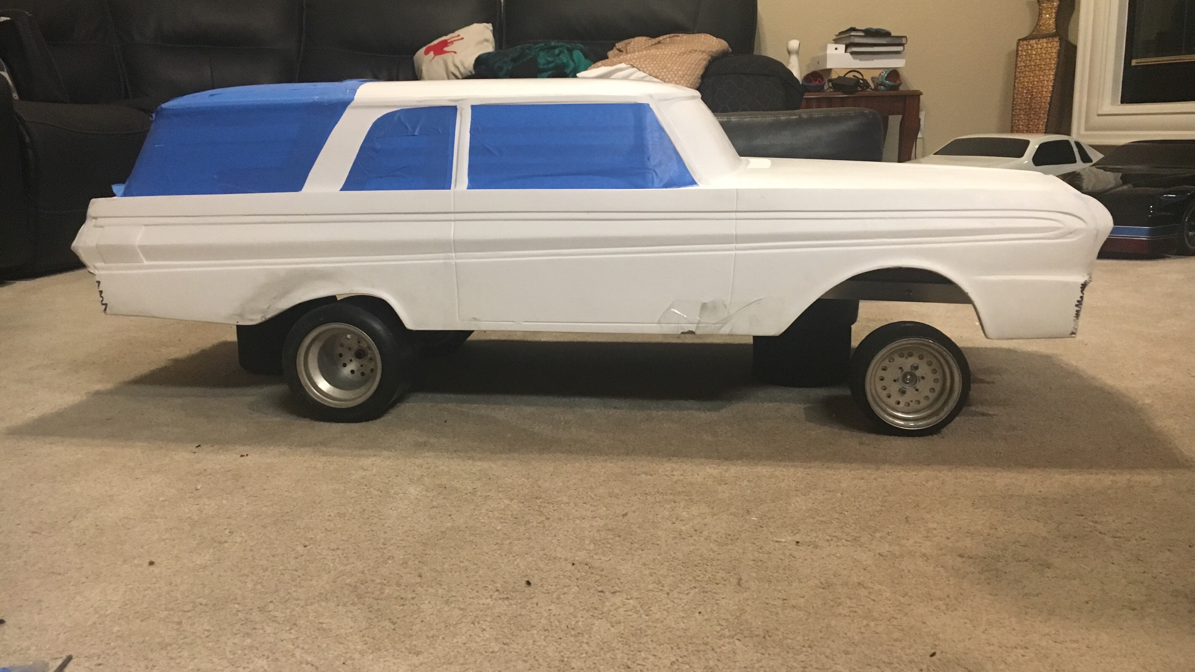

So I got some motivation today and started tinkering... don't laugh.. and please ignore the mess in the background, it was arts and krafts in the living room today.
I taped off the rear portion of the wagon top to see how the roofline needs to be reworked, but you get the idea of the sedan look.
I then cut the bumpers off to make it easier to measure and align the rails and floor, still a lot to do but I got a good mock up going.
The worst part of this is the front wheel well is too large and set back too far (look at the distance from the front of the wheel opening to the front of the fender) .. so I will have to move things around to correct it. And my tires are too small. But you see where it's going

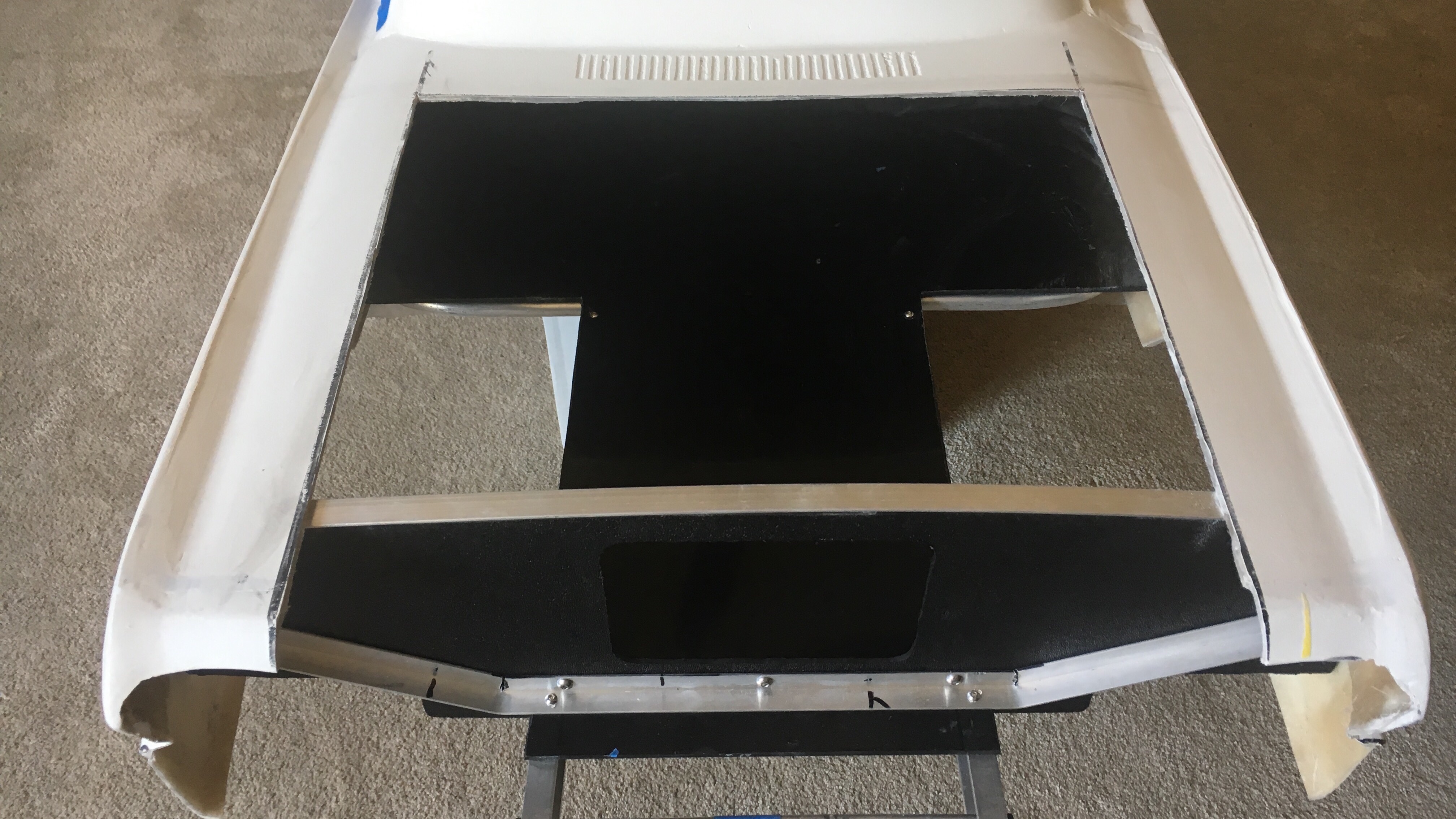

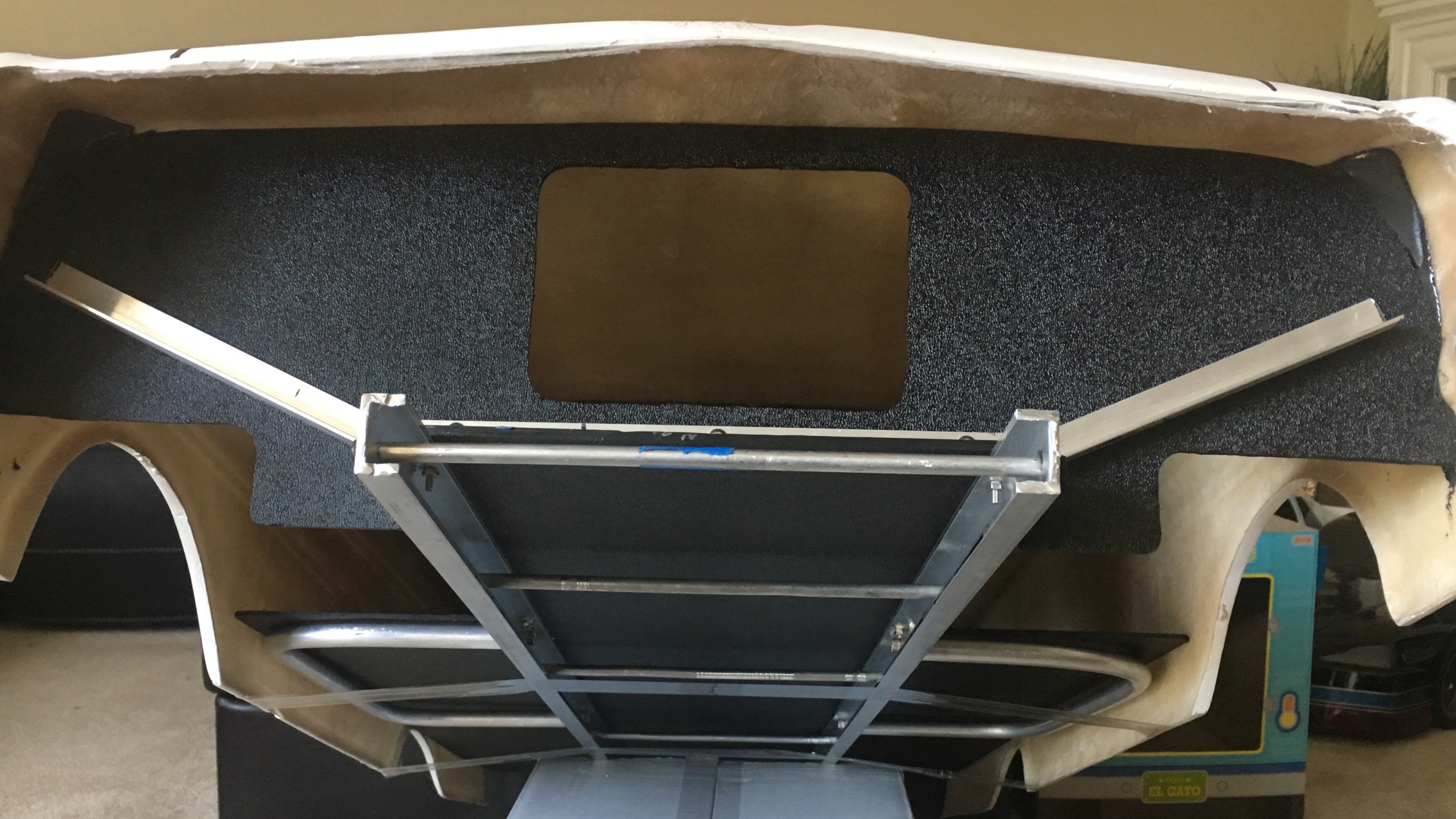

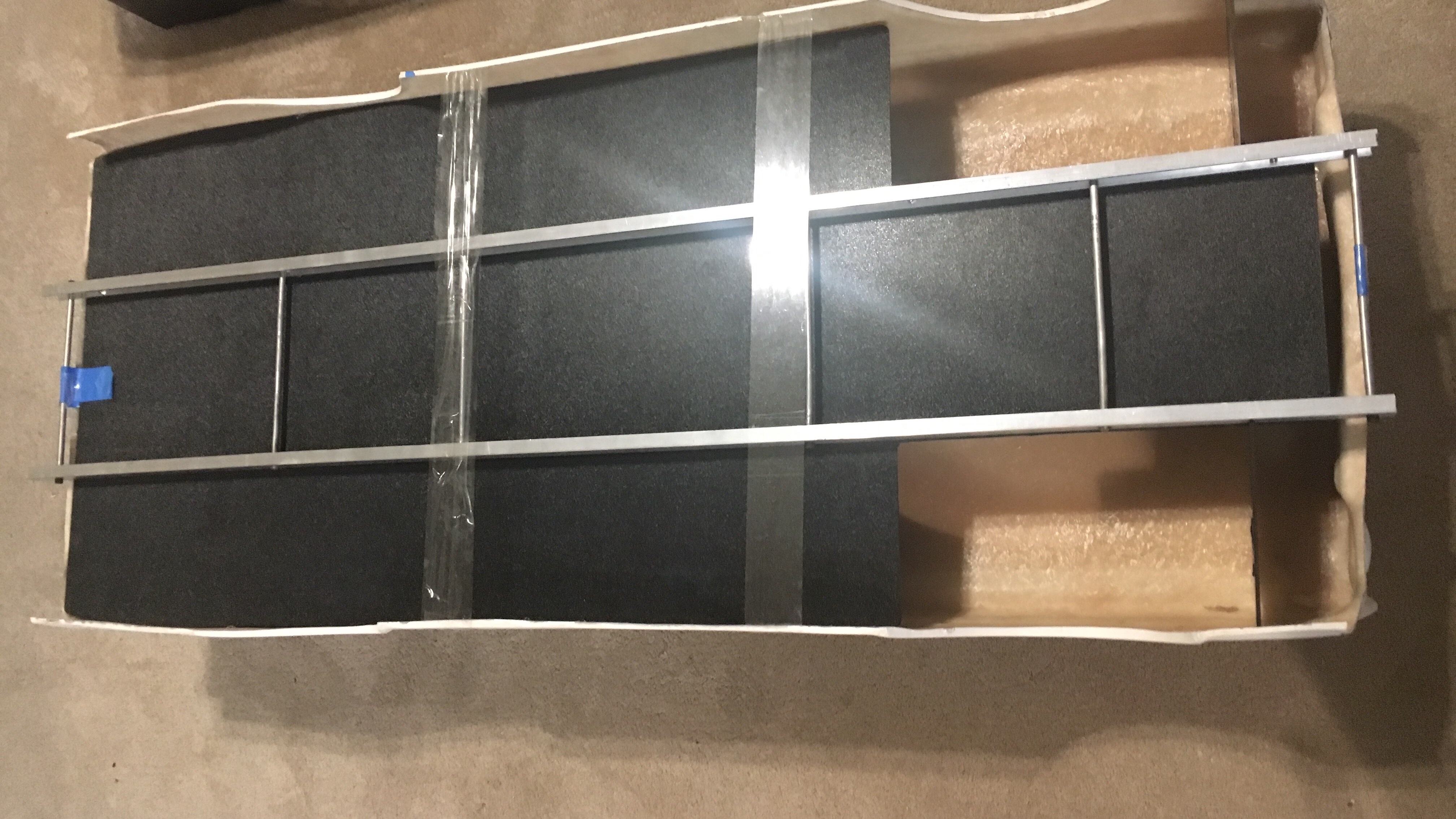

I got the body mounts mocked up
14 bolts total. I have decided that I will make the car serviceable through the hood and trunk since removal of the body will require pulling the bumpers, grille and the 14 mounting bolts... that's just too much.
Im waiting on the motor so I can get it mounted before I build the frame crossmembers
This is all still very rough but hopefully you can see where it's going ..
